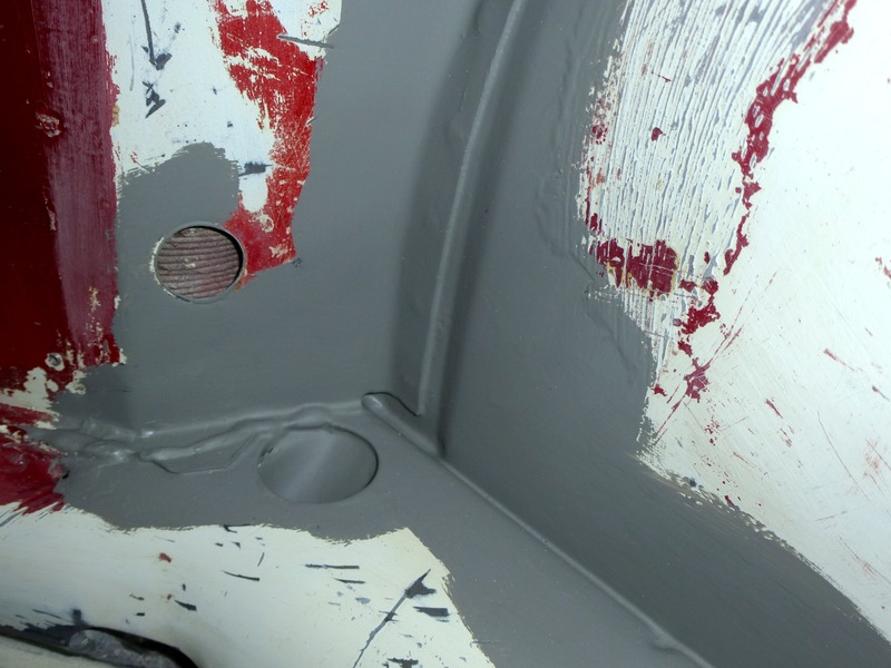

Cleanup continued...
All the old encrusted glue finally removed...
Wheel arch seam cleared...
After some additional sanding a first layer of primer was put on...
Now for some seam sealer...

Applied a final layer of primer...

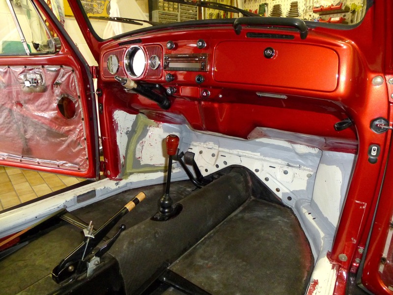

Gutted the passenger side door...
Added some additional wires for the HIFI system before the harness went back in...
Wiring & sound deadening...
Glued the kick panels to the wheel wells using MS Polymer sealant...
Applied butyl sound insulation mats to the battery area...
